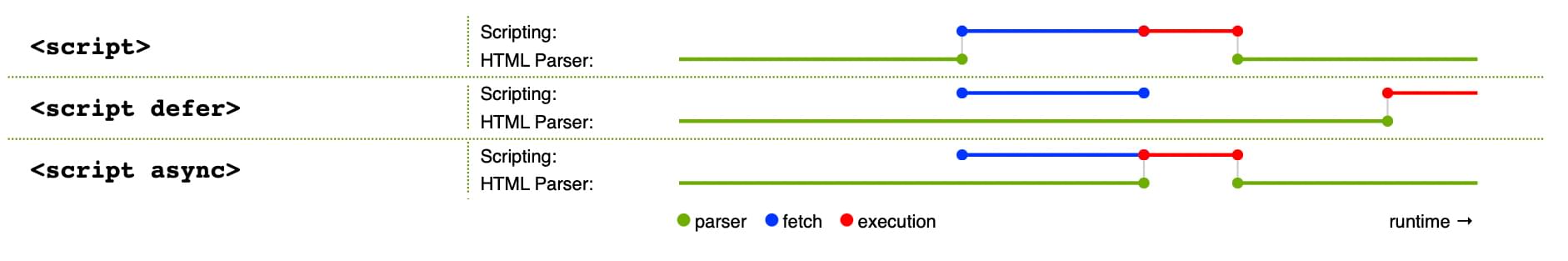

async and defer
Scripts loaded using the async attribute will download the script without blocking the page while the script is being fetched. However, once the download is complete, the script will execute, which blocks the page from rendering. This means that the rest of the content on the web page is prevented from being processed and displayed to the user until the script finishes executing. You get no guarantee that scripts will run in any specific order. It is best to use async when the scripts in the page run independently from each other and depend on no other script on the page.
Scripts loaded with the defer attribute will load in the order they appear on the page. They won't run until the page content has all loaded, which is useful if your scripts depend on the DOM being in place (e.g., they modify one or more elements on the page).
Here is a visual representation of the different script loading methods and what that means for your page:
How the three script loading method work: default has parsing blocked while JavaScript is fetched and executed. With async, the parsing pauses for execution only. With defer, parsing isn't paused, but execution on happens after everything is else is parsed.
This image is from the HTML spec, copied and cropped to a reduced version, under CC BY 4.0 license terms.

To summarize:
  • async and defer both instruct the browser to download the script(s) in a separate thread, while the rest of the page (the DOM, etc.) is downloading, so the page loading is not blocked during the fetch process.
  • scripts with an async attribute will execute as soon as the download is complete. This blocks the page and does not guarantee any specific execution order.
  • scripts with a defer attribute will load in the order they are in and will only execute once everything has finished loading.
  • If your scripts should be run immediately and they don't have any dependencies, then use async.
  • If your scripts need to wait for parsing and depend on other scripts and/or the DOM being in place, load them using defer and put their corresponding <script> elements in the order you want the browser to execute them.
